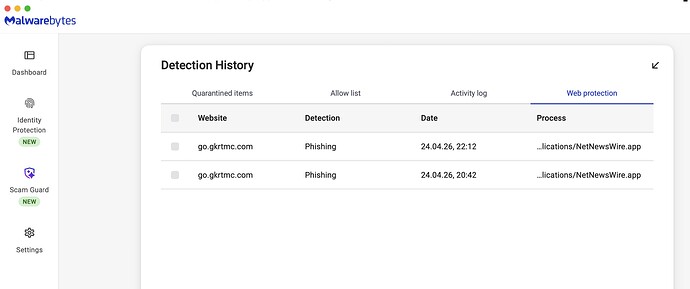

I have a Malwarebytes detection of a known phishing site’s URL inside a feed.
How can I find the feed?

This was found yesterday by MWB:
I want to delete the feed that contains this but I can not find the feed.

What I would do is write a little script that searches through the DB.sqlite3 database in each of the account folders in:
~/Library/Containers/com.ranchero.NetNewsWire-Evergreen/Data/Library/Application\ Support/NetNewsWire/Accounts
For each of the relevant columns in the articles table, it should check to see if it contains the string go.gkrtmc.com and report the articleID, title, and feedID when it finds it, so you can know in which article it was.
