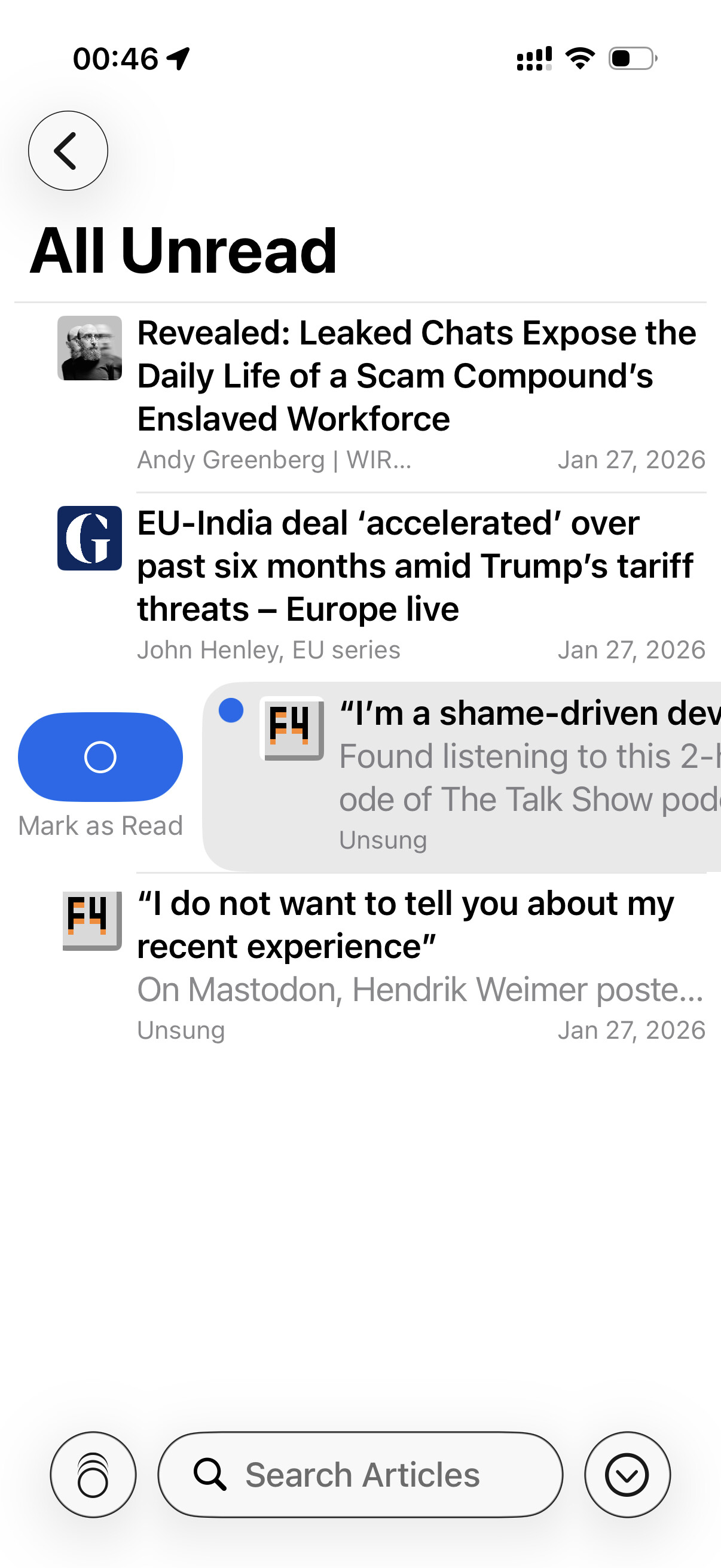

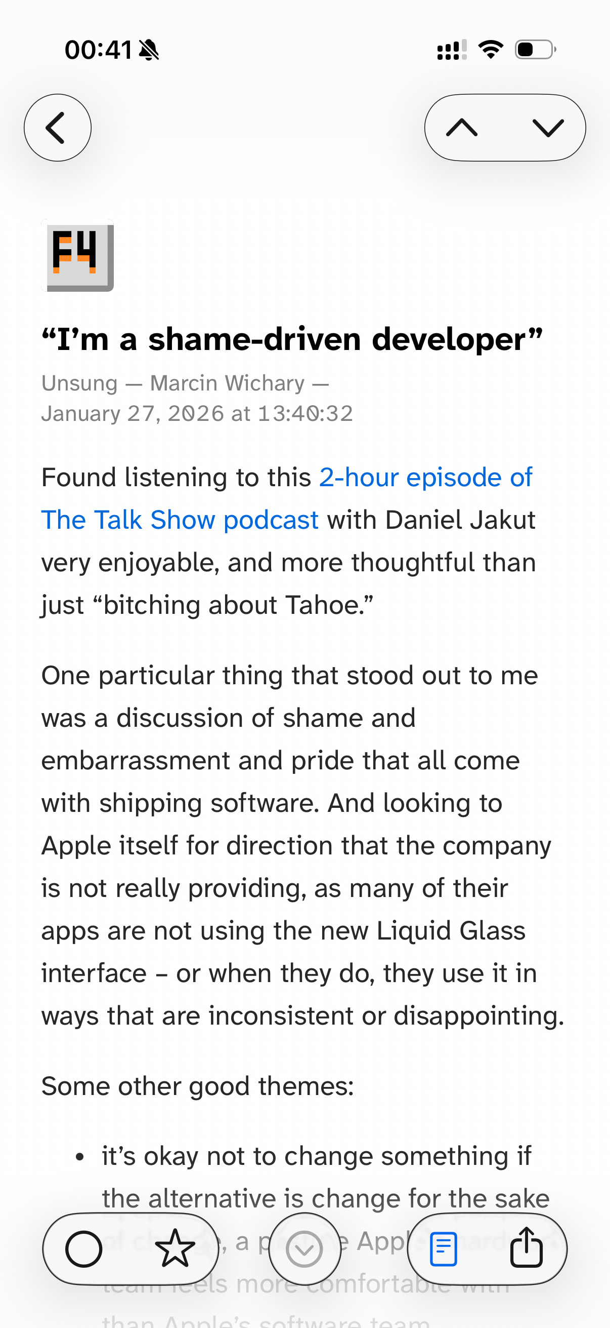

Here’s a screen capture when reading a post. The round icon is clear showing that the post is in the read state:

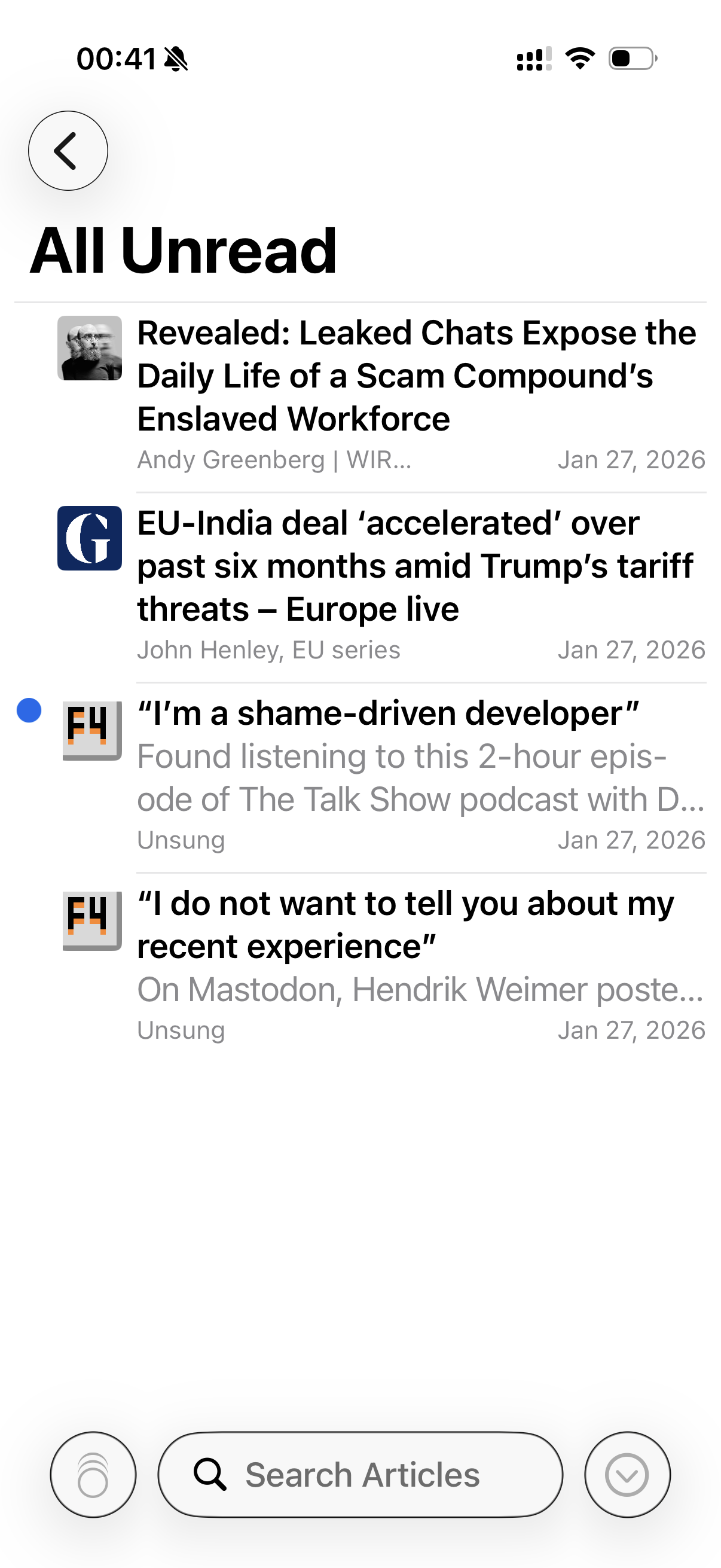

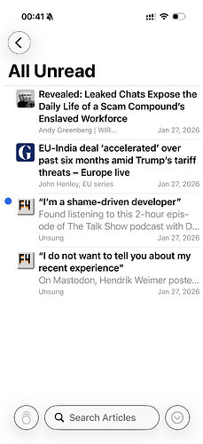

Now swiping to the right to go back to the Unread page, this post appears with the round icon blue showing it as unread:
This post seems rather sticky, as trying to mark it read in that view it failed several times until I took this screen capture:
I was wondering if it may a timing issue and that I styed longer on the post, while taking a screen capture, to change its status. However if that’s the case it affects only the first changing to read status as trying to change the read status fast of any of these four items now is working fine.
I’m now trying to change the read status of this same item in the item view (same as first screen capture). It does turn to blue, however when I return to the All Unread page, it shows as unread so it hasn’t stuck.
