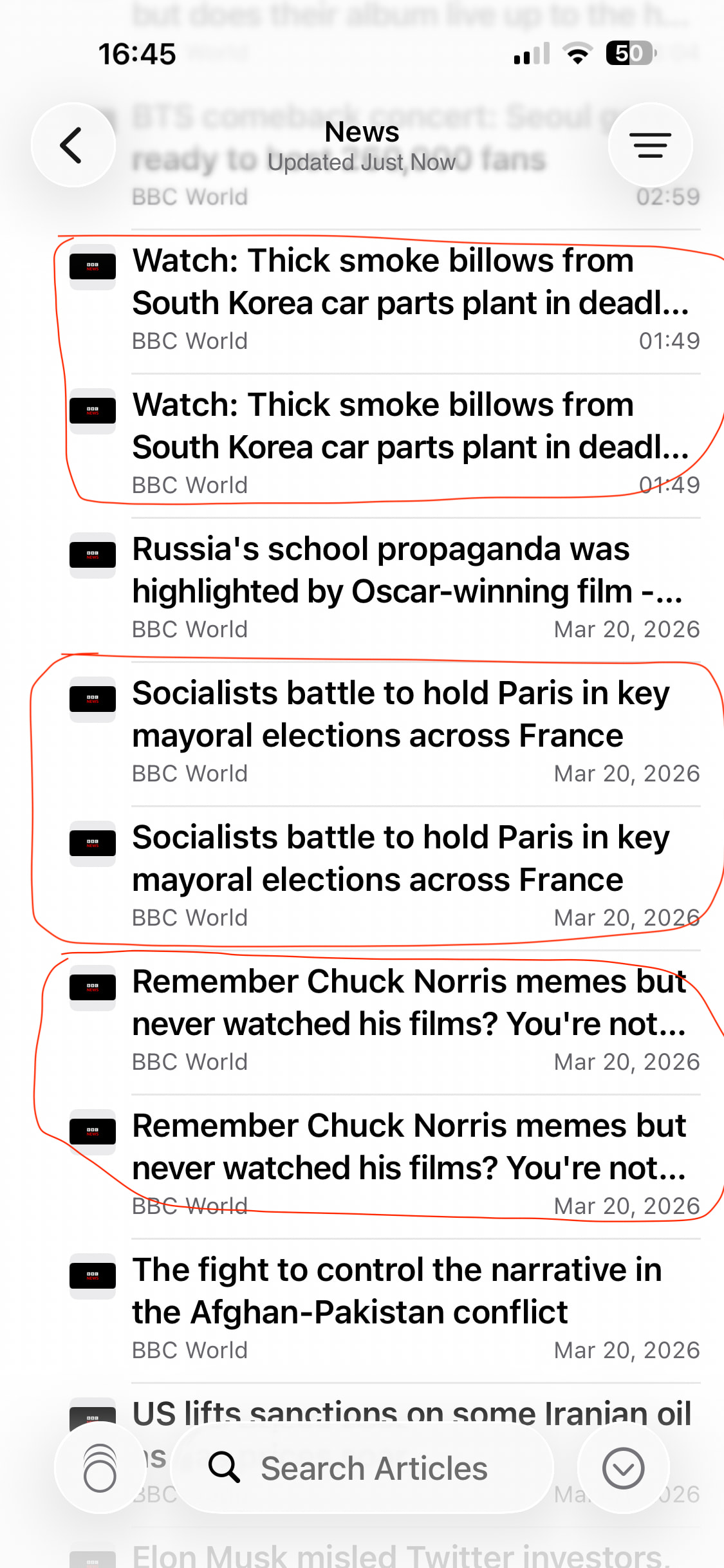

I have some articles always come with duplicates, sometimes even tripled, especially BBC (see screenshot). I use NNW on Mac, iPhone and iPad synced across via iCloud. Not sure how to fix it or where to start?

The BBC feeds turned buggy some months back — bad enough that I removed BBC from the default list of feeds.
If you’re seeing this with feeds other than BBC, let me know the feed URLs. It’s always a bug in the feed, but sometimes it’s one we can detect and work around.
No, only see with BBC. What would you recommend to do? Just remove?
If the duplicate articles annoy you, the only option is to remove the feed. The BBC update an article’s id every time the article is updated, so NetNewsWire (and other readers) see them as different articles.
