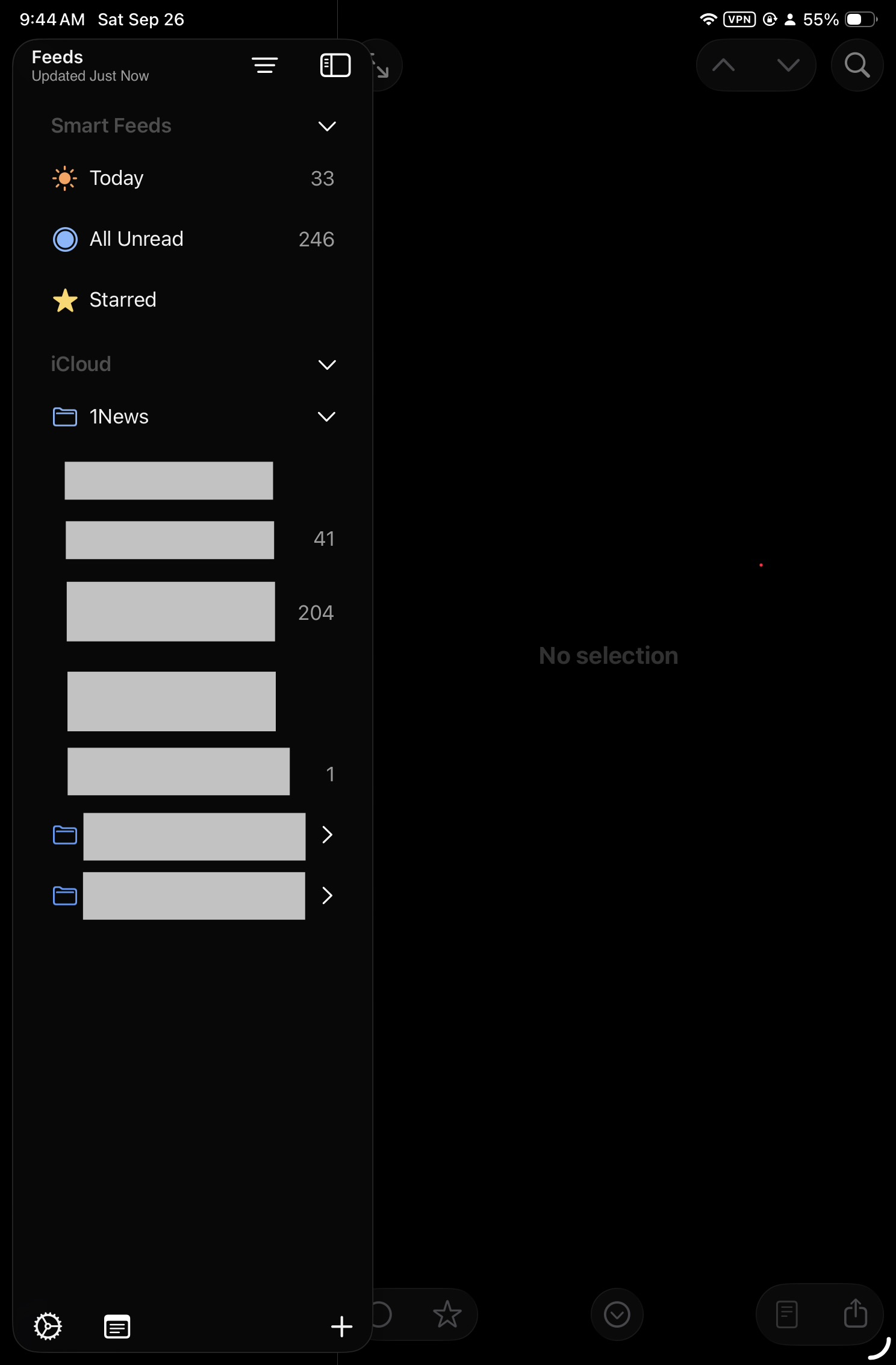

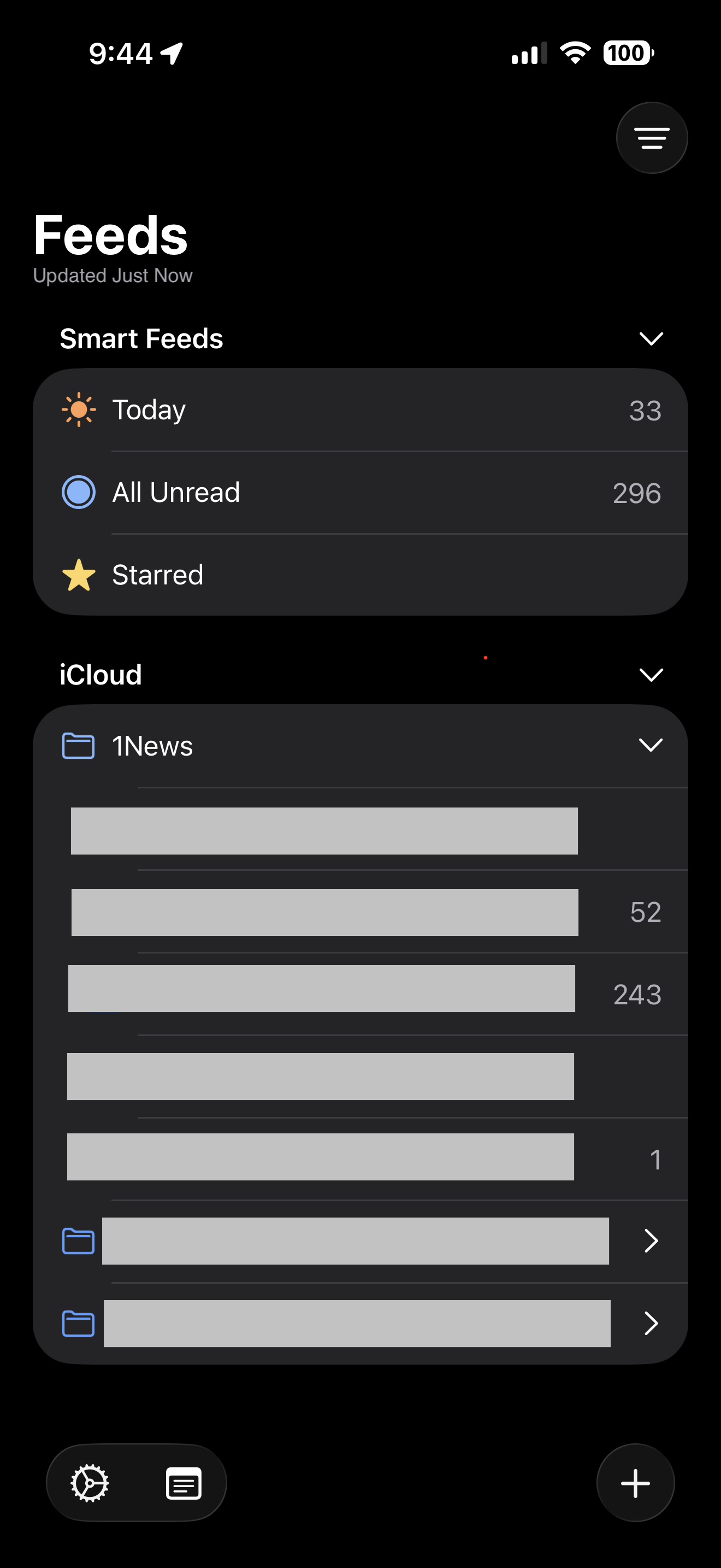

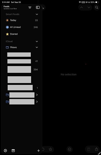

Using the latest version of NetNewsWire (7.1.4 Build 7213) on two devices (iPad and iPhone), synced using iCloud. Lately, the article status (read/unread, star) has not been in sync across both devices, no matter how many times I refresh the feed list.
On iPad:
On iPhone:

Is there a way to force a refresh that makes sure the article status is identical across devices?
After a bit of trial and error, I can confirm what does not work is
  1. Setting the “iCloud” account to “Not Active” and back again (this does nothing for the article status)
  2. Removing the “iCloud” account from NNW and re-adding it (this zeros out the unread count to whatever the current RSS feed provides, which is usually limited to the first 30-ish articles for my particular feeds, thus making the two devices even more out-of-sync)
The only solution that did work was using a third-party solution (iMazing) to back up app data from one device and restore it on the other, which while successful is a very time-consuming process that does nothing to ensure that the article statuses will not go out of sync again after some time.
Perhaps an app option to back up and restore all settings (including article status) would be work looking into? I know that this has been mooted and rejected for cross-service imports and exports, but perhaps limiting it to this app exclusively would be more doable? Just an idea.

Unread counts may not match for a couple of reasons.
Syncing isn’t immediate, for one thing. A change you just made might not have made it to the other copy of NetNewsWire yet. (It might be quick but it might take a half hour or more.)
Also: you might not have the same articles in each copy of NetNewsWire. If you use one copy of NetNewsWire more often than another, you might find that the less-used copy misses articles that came and went before it had the chance to see them.

Thanks for the reply! If this is indeed the case (the feeds which are most out of sync are from daily newspapers, and I did not use one of the devices for a few days), then would turning on article content sync fix it?
Yes, turning on article content sync would fix it, though not immediately. (It would sync the content of new articles, but not existing articles.)
